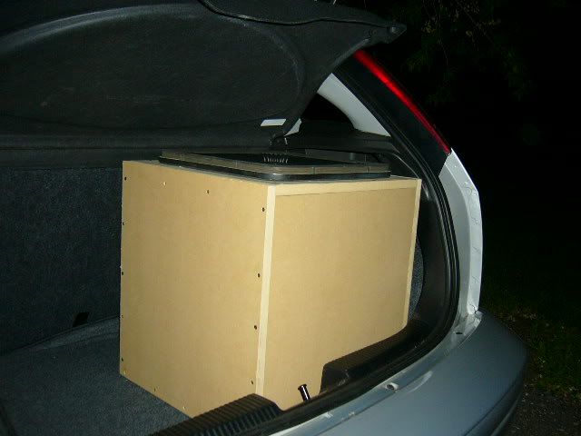

So i opted to build a sub enclosure. Not bad for a first timer. I went to the Kicker website, found my speaker size, and got the specs for the MIN sized box. 1.5 cubic feet needed for a 15 inch sub. Thats not that big...OR IS IT.
HOLY s***....its a monster of a box. and i think my ears are bleeding..bwhahahahaahah....love it.
the only un-enjoyable part...doing the math and trying to figure out 1.5 cubic feet of box...equals what in MDF...
PICS TO COME...
Just in case you are wondering.
you'll need: (3/4 inch MDF)
2 pieces of 18"x 18"
2 pieces of 18"x 19.5"
2 pieces of 19.5" x 19.5"
Side note: You can get all this out of a 3/4 sheet of MDF it'll run you about 22 bucks for it. DON'T BUY A FULL SHEET. you don't need it. besides you'll have plenty of extra pieces after it all.

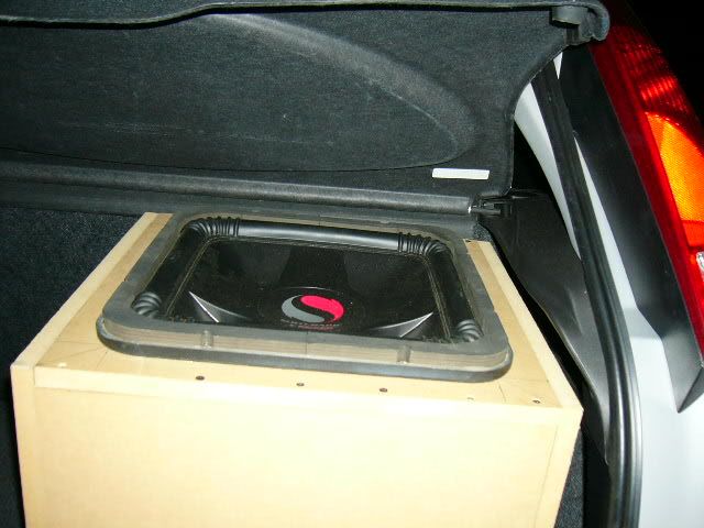

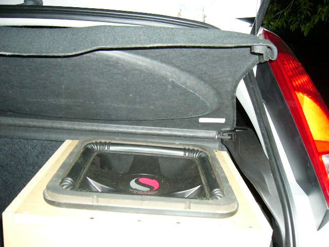

AS PER REQUEST.
Sorry about quality...it was night time, i was drunk, and i have yet to put the carpeting on the enclosure...(hence the woody look...)
[Image: Picture085.jpg]
[Image: Picture084.jpg]
[Image: Picture083.jpg]
[Image: Picture082.jpg]
Wow so where's the rest of your hatch?. I'm trying to get away from the big box in my back and make a side box so that I have "trunk" room again.
That's ginormous. What amp's running that monster?
That is huge, it takes up half the trunk too. Does it sound any good?
