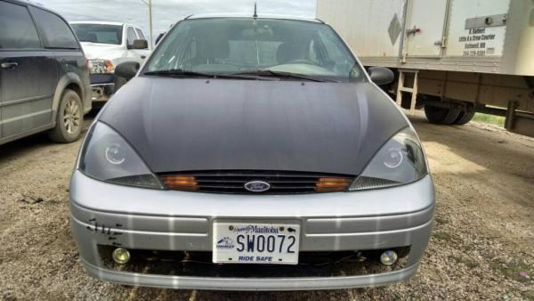

not sure If I posted the lights anywhere, but heres what I did.
nice dide those look great.. you should run a light bar in that giant opening in your bumper lol

Finally got off my ass and wired everything up!
I just used wiring from my fog lights that have been removed, and tapped into the turn signals in the grill. Turns out its the blue wires, on the outside if the plug. For future reference.
Pulled out r12 relay to disable the HID'S as my DRL. So its just the led rings as DRL now. Hopefully i don't get any issues from cops.
[Image: IMG_20150907_132532630_HDR_zpsooqfvlpg.jpg]
[Image: IMG_20150907_132510092_HDR_zpsyumk0jwb.jpg]
Like my bumper stitching job? lmao. keeping my eyes open for an svt bumper on kijiji
