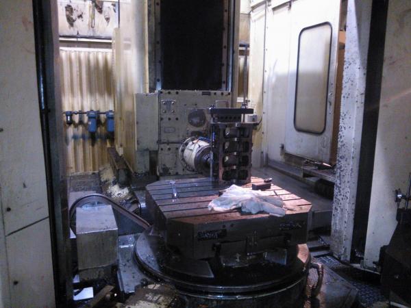

Boring out the engine block at my buddys work on a machine far bigger than required hahaha.

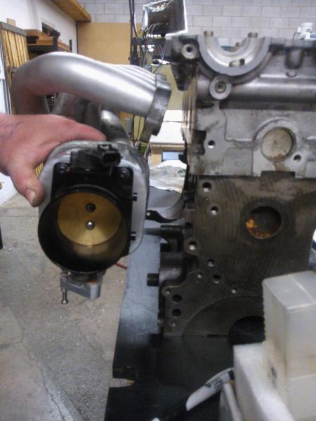

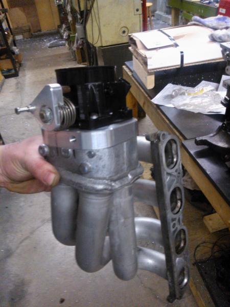

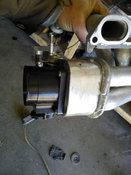

This is the majority of the intake ive used, I machined down a 1.8-2.0L Toyota camry tubular stock intake, fitted an aluminum plate for the throttle body and still need to make an adaptor from flange to head, with ports for fuel injectors as the toyota used theirs directly in the head, foci has them in the manifold.
This is the intake manifold to head/block relation once an adaptor is fabbed.

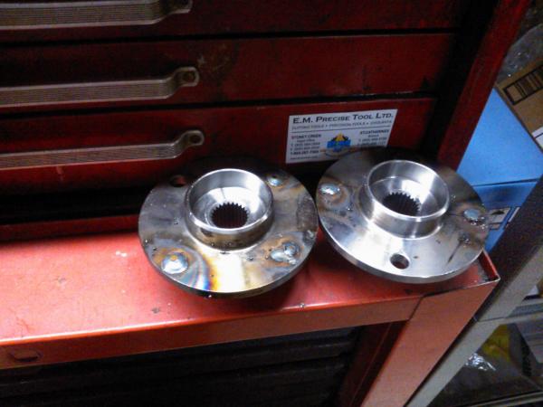

Front hubs 3 of 4 holes filled up, waiting to get machined and drilled.

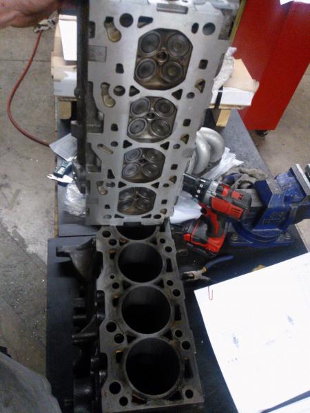

The deck of the head and block, head was skimmed on 3 sides, block was bored out for bigger pistons

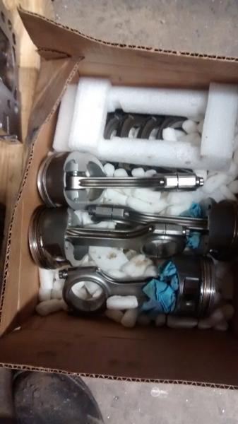

Pistons n Rods

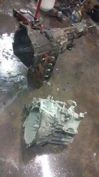

Both transmissions side by side, before cleanup of the T5

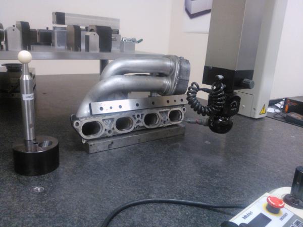

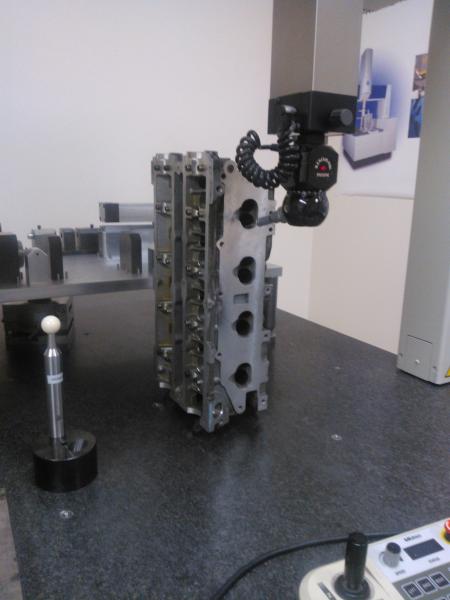

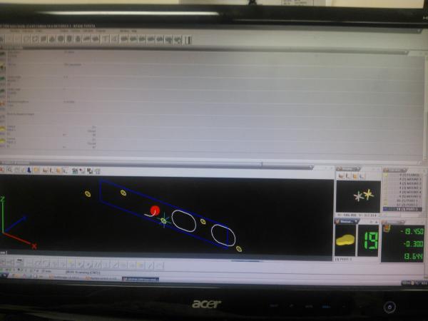

So i took some time after work today to throw my head and intake up on the CMM, which is basically cheating when it comes to the reverse engineering world, but it works like no other Wink
Heres the intake, taking hits on the ports and bolt holes
The Mitutoyo software and graphical interface showing what the CAD file will eventually look like.
Measuring out the head

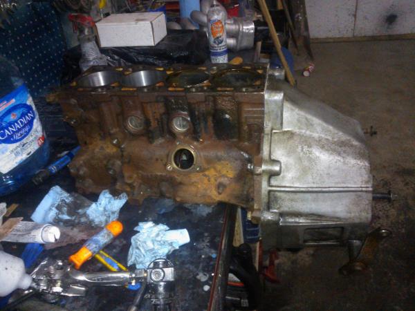

The zetec block has 3 bolts line up on the 4cyl T5 bellhousing, so im probably just going to weld two blocks to the top 2 mount holes and make it bolt on. The only issue i see is the centering of the trans to crank (which i will measure), and the starter location and interference.
I got my intake flange welded up and ground down nicely. Im going to weld over another bead to make sure it sealed up later.

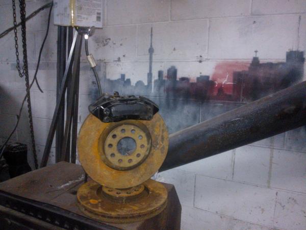

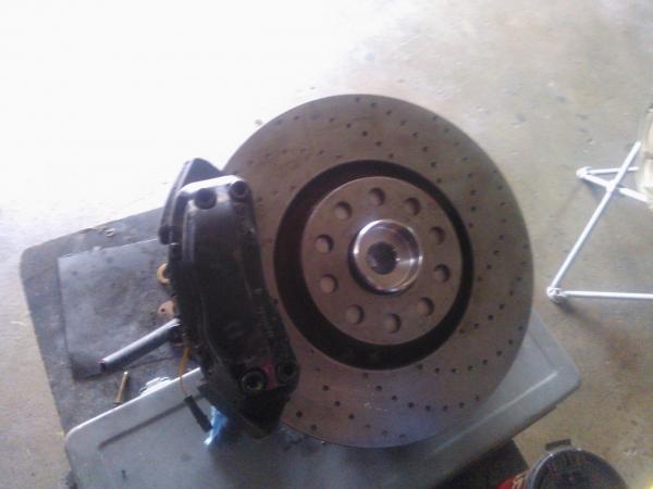

I may have to change my front brake setup to use these, 320mm audi S4 rotors and Mercedes S430 4 piston brembos. I think that may stop the car just about good and sexy Smile

Seems like the crank to input shaft alignment is out about .040" but it's well within the realm of plugging and re-reaming new dowel holes, the holes for bolts have enough clearance in them. Finished honing out the block, one more steam bath and some bearings ordered and the short block will be assembled
So ive done a bit more work to get the Zetec behind a T5, Looks like the starter for a 4cyl mustang and bellhousing have the same offset for the ring gear for the zetec flywheel.

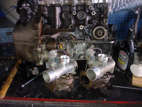

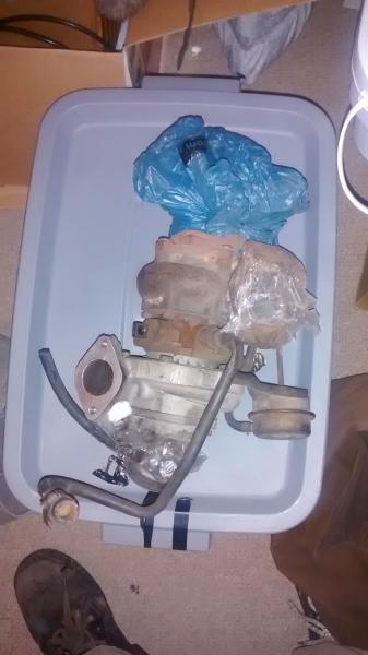

A Couple turbos ive picked up for rebuild, K04-022 borg warners from mazdaspeed 3-6s

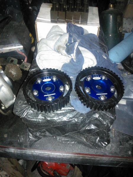

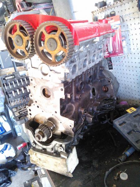

Adjustable cam sprockets Smile
Machined and dimpled Audi S4 rotors, Mercedes S430 calipers, drilled 5x108 hubs Smile

Its going Smile rebuilt one of the k04 turbos last night, outside of a soft faced hammer, no special tools required. Not even snap ring pliers are required! I will probably start cutting valves when the cams get shipped to me in the next week or two. I'll probably use stock valve springs for now and just keep the revs down
