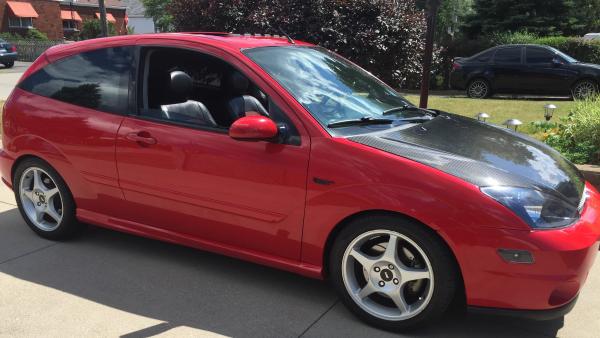

It's a Fun car with boost , Going to be installing a new clutch in the wagon then put it up for sale . The black 2011 focus in the background of the pic above is my new DD . Autotragic but it's a nice car overall , I'm gonna try and keep it all stock ...Lol

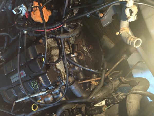

Well I said I was going to sell the wagon but I've decided to keep it for the time being . It's all torn apart in the garage . Took the transmission out , found that the Windage tray seal was leaking oil onto the clutch , which caused it to wear out and slip . So it's opened up a bigger can of worms ...but nothing I can't handle , just prolonging me getting her back up and running . So I plan on dropping the tray down and replacing the seal . Slapping a lower mile transmission in it , stock clutch and flywheel , contour t-stat housing and she should be good to go. Also picked up a set of  Contour SVT wheels that I plan on putting on for the winter .
